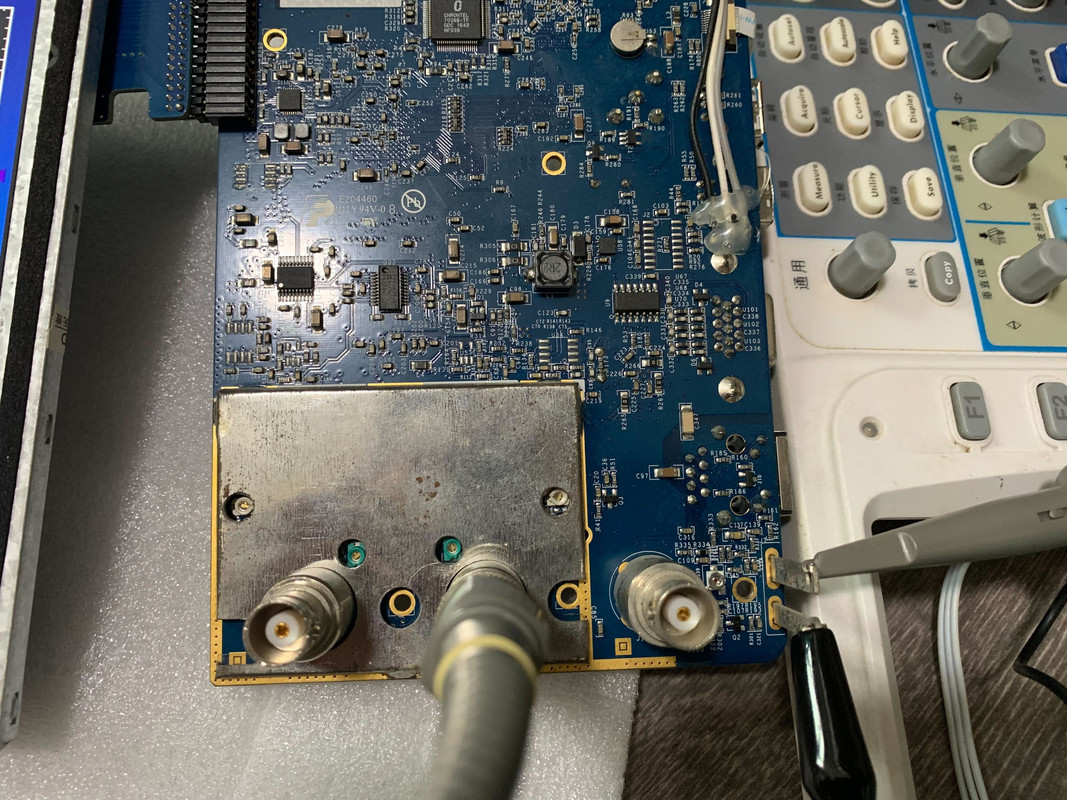

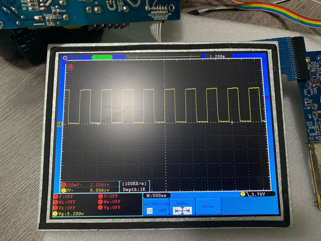

Зарегистрирован: Пт июл 30, 2021 12:17:19
Сообщений: 5
Hi everyone, have anyone faced the issue that the oscilloscope displays wrong frequency and voltage. I replaced the NAND long time ago and bought P6100 probes, not sure what went wrong.
Read 1.25KHz and 3.76V instead of 1KHz and 5V
Will those trim pots help to calibrate?
