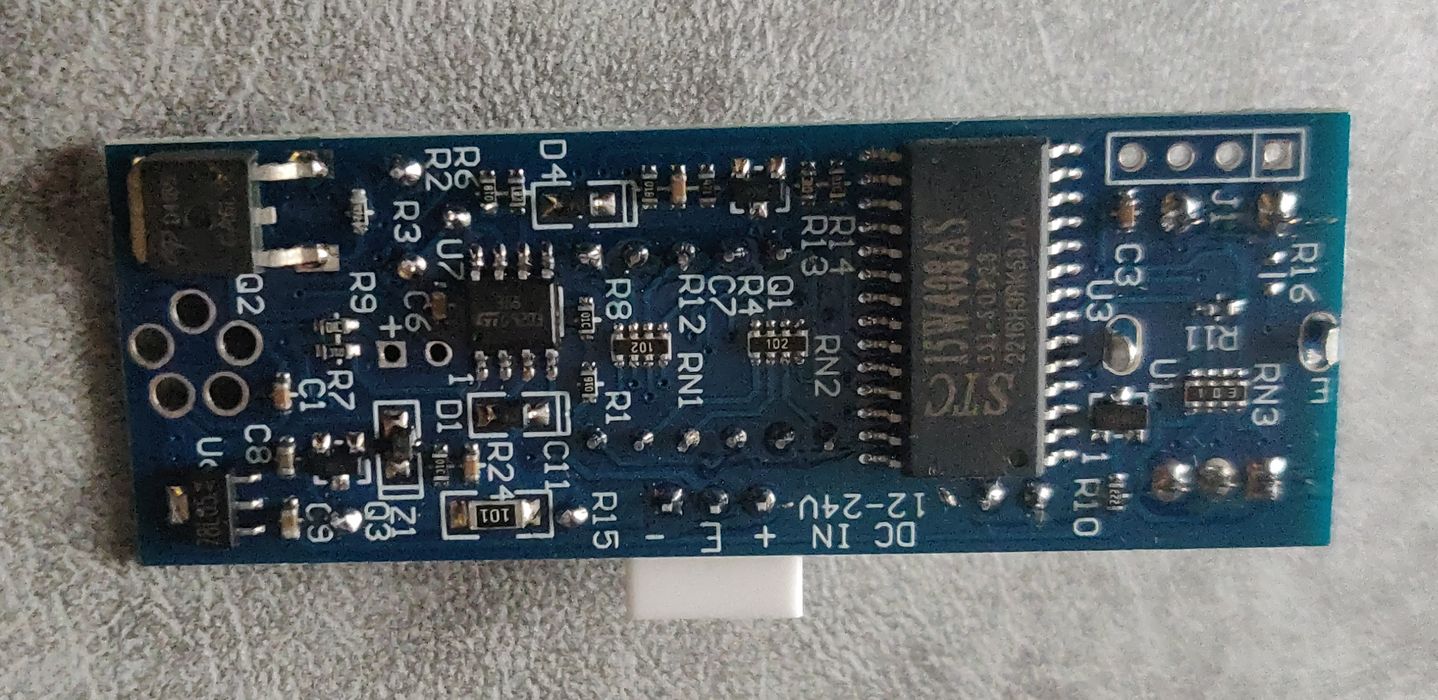

Всем счастливым обладателям конструктора "Electric Unit Digital Soldering Iron Station Temperature Controller Kits for HAKKO T12 Handle DIY kits w/ LED vibration switch" New 2017 с разъемом по питанию на плате контроллера и надписью " Mini STC T12 SUHAN Ver:E" посвящается!
Во вложении фотка платы.
Т.к. все поиски описания меню контроллера оказались тщетными (на просторах и-нета много обзоров и видео, но более ранних версий), ввязался в жесткую полемику с китайскими продавцами сего чуда и вот, что удалось добыть:
Controller parameter setting mode
(The default has been set, no special requirements, please do not set up a random)
Press and hold the encoder button does not move → start → enter the parameter settings mode:
P11, P02, P03, P04, P05, P06, P07, P08, P09, P10, P11 digital display menu for 1.5 seconds, and then automatically display the corresponding parameters of this menu, then the left encoder Press the button to automatically save the currently set parameters, then display the next menu for 1.5 seconds, and then display the corresponding parameters of this menu, and so on. When all the parameters (Such as you just want to set P01, set up after the P01 can be turned off and then boot into the normal mode), you can always turn off the machine,
Menu item:
P00: restore the default parameters (0 or 1, the default value of 0,0 for the recovery, 1 for the recovery)
P01: op amp gain (200 to 350 times, step 1, default 230)
P02: Operational amplifier offset voltage (0 ~ 250mV, step 2, the default value of 100, refers to the tip to keep the room temperature operational amplifier inherent output voltage, according to my measurement this voltage varies greatly with temperature, different magnification Not the same, the higher the magnification, if you do not measure, please keep the default value)
P03: thermocouple ℃ / mV data (30 ~ 50, step 1, the default value of 41, refers to the thermocouple need to temperature how much voltage was increased by 1mV, according to the type of thermocouple self-calculation, if you do not understand, please keep Defaults)
P04: temperature adjustment step (0,1,2,5,10 degrees optional, 0 can lock the soldering iron temperature)
P05: sleep time (how long does not move into sleep) (0 ~ 60 minutes, step 1, 0 is to disable the sleep function)
P06: Shutdown time (0 ~ 180 minutes, 0 ~ 30 step into the steps of 1,30 ~ 180 step 10, 0 is disabled shutdown function)
P07: temperature correction (+20 degrees, step 1) (due to NTC resistance in the chassis, the soldering station heat will lead to the detection of NTC temperature higher than room temperature, resulting in high temperature compensation of the thermocouple, soldering iron temperature is not accurate, or other If you set the other parameters are set to the correct value of the temperature is still high or low, you can use this parameter correction. For example, to detect the displayed soldering iron temperature is 20 degrees higher than the actual value of this parameter will be set to 20)
P08: wake mode (0,1, 0 in the shutdown mode can be rotated in the encoder can shake the handle to wake up, 1 can only rotate the encoder wake up (Note: press the encoder can not wake up, can only rotate) )
P09: temperature increase mode to increase the temperature to adjustable (20 degrees to 100 degrees adjustable, adjust the pace of 10 degrees)
P10: temperature to increase the duration to adjustable (adjustment range of 10 seconds to 250 seconds, adjust the step 5 seconds)
P11: Parameter setting mode Auto save parameter and return to heating mode Function to active time adjustable (range 4 seconds to 60 seconds)
Надеюсь, старался не зря и кому-то будет полезен сей опус.

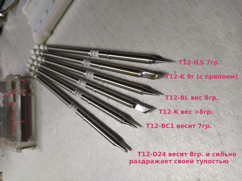

Теперь по делу:
1. Действительно ли Hakko T12 использует встроенную последовательно термопару, или для измерения используется температурный коэффициент керамического нагревателя?
У меня есть несколько образцов керамических нагревателей (ТЭН). Среди них есть и без температурного коэффициента.
Образец Hakko температурный коэффициент имеет.
В подлинности дополнительно заказанных жал-картриджей T12 я сомневаюсь, не смотря на то,что в они холодном состоянии имеют сопротивление 8 Ом (7-9МОм по отношению к корпусу) и блестят лучше чем "у кота яйца".
Жало пришедшее в комплекте с набором выглядит будто его сначала допиливали напильником, а потом никелировали. (сопротивления при этом совпадают)
2. Если там всё-же используется термопара, то какого она типа?...
3. Смотрел схемы готовых устройств. Там подключение измерительной части слабо похоже на подключение для термопар. (о температурной компенсации холодного спая вообще молчу)
4. Видел заметки в которых рекомендуют сначала прокалить картридж, а только потом смотреть на показания его измерений... это точно не похоже на применение термопары.
5. Выяснил, что сопротивление датчиков вибрации в замкнутом состоянии неимоверно большое... Речь идёт о двух датчиках которые шли у меня в комплекте KIT-набора. Оно настолько большое (около 1Мом), что в разомкнутом его вывод возможно будет использовать как для отвода статического напряжения, так и для дистанционного датчика (на основе наводок электросети) приближения.
Предлагаю:
1. Измерить наличие э.д.с. на нагревательном элементе в разогретом состоянии. (чтобы отгадать какого типа термопара, если она там вообще есть)
2. Измерить сопротивление нагревательного элемента при разных температурах. Это нужно чтобы сравнить все варианты чем мы все пользуемся. (возможно конструкция подойдёт даже для 900-ой серии)
3. Любым возможным способом узнать разность между показаниями "термопары" и концом жала. (Имеется ввиду разность во времени. Это нужно чтобы настроить форсированный разогрев при касании к паяльнику)
4. Создавать конструкцию "кошкин паяльник" собираюсь либо на Atmel либо на STM.

таки да... нагреватель практически одинаковый а жала очень отличаются по форме и массе - он бы так резво не реагировал.

Приобрел паяльник на Т12. Версии платы указаны mini stc t12 ver F и ver 2022.
Не работает меню настроек. Видимых пустых мест перерезанных дорожек нет. Куда устанавливать перемычку test?
Фото платы прилагаю
0002.jpg [227.88 KiB]
0001.jpg [213.99 KiB]

а кому нибудь встречалась схема mini stc t12 ver 2022, непонятно обрабатывается датчик вибрации, вернее то работает то нет. мультиметром сам датчик нормально звонится. мерил напряжение параллельно датчику вибрации - когда замкнут то стабильно 0 а когда разомкнут то 1,5В то 0,5, то 1В.

сделал подтяжку через делитель напряжения, на ногу МК к которой подключен датчик вибрации - теперь всё работает как надо.
