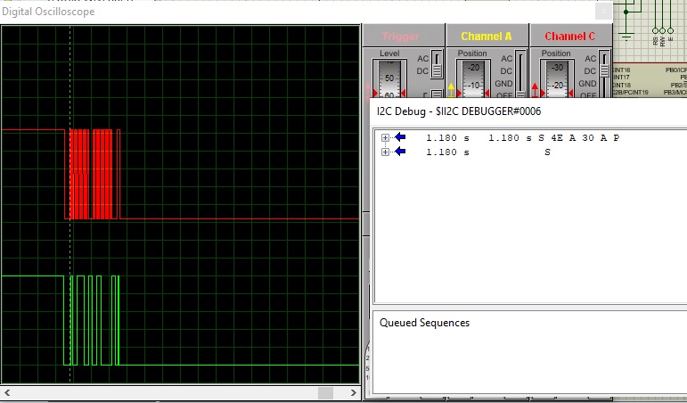

Всем привет! Решил использовать библиотеку с прерываниями, всял с chipenable.ru использую на atmega328p.

ISR (TWI_vect) {
   static unsigned char TWI_bufPtr;
   switch (TWSR)
      case TWI_START:             // START has been transmitted
      case TWI_REP_START:         // Repeated START has been transmitted
         TWI_bufPtr = 0;         // Set buffer pointer to the TWI Address location
      case TWI_MTX_ADR_ACK:       // SLA+W has been tramsmitted and ACK received
      case TWI_MTX_DATA_ACK:      // Data byte has been tramsmitted and ACK received
         if (TWI_bufPtr < TWI_msgSize)
            TWDR = TWI_buf[TWI_bufPtr++];
            TWCR = (1<<TWEN)|                          // TWI Interface enabled
            (1<<TWIE)|(1<<TWINT)|                      // Enable TWI Interupt and clear the flag to send byte
            (0<<TWEA)|(0<<TWSTA)|(0<<TWSTO)|           //
            (0<<TWWC);                                 //
         } else {                   // Send STOP after last byte
            TWI_statusReg.lastTransOK = TRUE;          // Set status bits to completed successfully.
            (0<<TWIE)|(1<<TWINT)|                      // Disable TWI Interrupt and clear the flag
            (0<<TWEA)|(0<<TWSTA)|(1<<TWSTO)|           // Initiate a STOP condition.
            (0<<TWWC);                                 //
      break;
      case TWI_MRX_DATA_ACK:      // Data byte has been received and ACK tramsmitted
         TWI_buf[TWI_bufPtr++] = TWDR;
      case TWI_MRX_ADR_ACK:       // SLA+R has been tramsmitted and ACK received
         if (TWI_bufPtr < (TWI_msgSize-1) )             // Detect the last byte to NACK it.
            (1<<TWIE)|(1<<TWINT)|                      // Enable TWI Interupt and clear the flag to read next byte
            (1<<TWEA)|(0<<TWSTA)|(0<<TWSTO)|           // Send ACK after reception
            (0<<TWWC);                                 //
         } else {                   // Send NACK after next reception
            (0<<TWEA)|(0<<TWSTA)|(0<<TWSTO)|           // Send NACK after reception
            (0<<TWWC);                                 //
      break;
      case TWI_MRX_DATA_NACK:     // Data byte has been received and NACK tramsmitted
         TWI_buf[TWI_bufPtr] = TWDR;
         (0<<TWWC);                                 //
      break;
      case TWI_ARB_LOST:          // Arbitration lost
         (0<<TWEA)|(1<<TWSTA)|(0<<TWSTO)|           // Initiate a (RE)START condition.
         (0<<TWWC);                                 //
      break;
      case TWI_MTX_ADR_NACK:      // SLA+W has been tramsmitted and NACK received
      case TWI_MRX_ADR_NACK:      // SLA+R has been tramsmitted and NACK received
      case TWI_MTX_DATA_NACK:     // Data byte has been tramsmitted and NACK received
//       case TWI_NO_STATE         // No relevant state information available; TWINT = “0”
      case TWI_BUS_ERROR:         // Bus error due to an illegal START or STOP condition
      default:
         TWI_state = TWSR;                          // Store TWSR and automatically sets clears noErrors bit.
         // Reset TWI Interface
         TWCR = (1<<TWEN)|                          // Enable TWI-interface and release TWI pins
         (0<<TWIE)|(0<<TWINT)|                      // Disable Interupt
         (0<<TWEA)|(0<<TWSTA)|(0<<TWSTO)|           // No Signal requests
         (0<<TWWC);                                 //
      break;

Код:
 messageBuf[0] = ( 0x27 << TWI_ADR_BITS ) | ( FALSE << TWI_READ_BIT ); // адрес ведомого + бит записи
messageBuf[1] = 0x12; // данные
TWI_Start_Transceiver_With_Data( messageBuf, 2 );
_delay_us(100);
messageBuf[1] = 0x30; // данные
Вижу, все хорошо!
2.jpg [102.96 KiB]
Пробую через 10мкрС...
Код:
_delay_us(10);
Отправилось только второя часть и завис на СТАРТЕ, линии SDA и SCL в низком уровне.
2_2.jpg [94.48 KiB]
А в библиотеке дисплея такие задержки есть
Код:
void lq_writeDevicePulse(LiquidCrystalDevice_t* device, uint8_t value)
lq_transmitI2C(device, value | LCD_ENABLE_BIT);
_delay_us(2);
lq_transmitI2C(device, value & ~LCD_ENABLE_BIT);
_delay_us(50);
только в этой функции, далее не нашел менее 150мкрС. Почему так тупит при малых задержках между отправками? Например в библиотеке INA226 при другой рабочей библиотеке TWI там между отправкой адреса с битом записи и отправкой данных - 10мкрС интервал.
