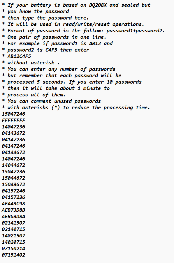

Hi All
Free for all
Unseal and Unseal Fas passwords for BQ20Z, BQ30Z, BQ40Z, BQ50Z chips
With these passwords you will be able to enter BotRom for most of the chips mentioned above
Use demo 4.52 Be2Wo.... and simply enter these passwords into the Passwords.txt directory
png1.png [19.28 KiB]
png.png [59.15 KiB]
